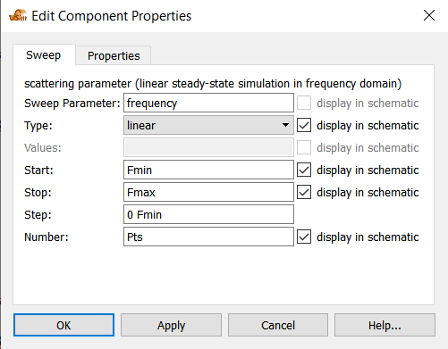

      Frequency sweep parameters START and STOP can be set with variable declarations in the schematic, but the SCH assignments cannot be edited in the sweep dialog box.

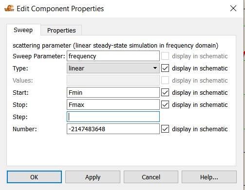

          For an S-Parameter simulation the START and STOP frequencies can be equated to a variable that is defined in an equation if the variable name is entered in the schematic (“Start=Fmin”), and all works as expected.  But when the S-Parameters properties dialog is opened an error occurs (“Step:  0 Fmin”).  Attempting to edit the step value causes the number of points to be calculated as a negative number.
