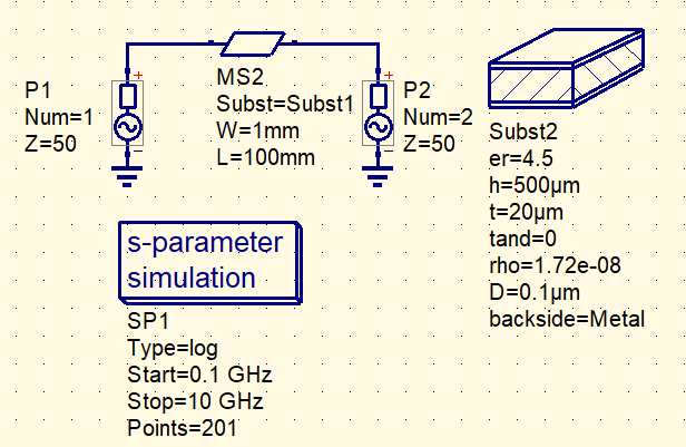

Home › Forums › Usage › How to plot Zo vs W/h This topic has 1 reply, 2 voices, and was last updated 1 year, 1 month ago by Carsten. Viewing 2 posts - 1 through 2 (of 2 total) Author Posts 19. October 2025 at 17:15 #9129 mdrashidalam65Participant <p style=”text-align: left;”>I am working on Microstrip lines and not able to plot Zo vs W/h. Can please anyone help</p> Attachments:line_cal2.png 19. October 2025 at 20:46 #9132 CarstenParticipant There are textbook formulas for that. you could add “parameter sweeps” for W and h and use normal formula blocks to calculate Z0. Then you should be able to plot with cartesian etc. Maybe you have to add a little rf simulation to satisfy Qucs Author Posts Viewing 2 posts - 1 through 2 (of 2 total) You must be logged in to reply to this topic.
