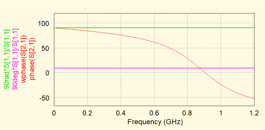

      Please look at the plot, you should understand everything.
      To those who are familiar with HFSS these results may look insane.
      The phase/wphase function should and returns degrees.
      In this plot any other function by default returns radians.
      When drawing a constant level in degrees it is scaled down.
      And when drawing a constant level in radians it is rendered in the same scale as degrees.
      What should be? The same scale of the plot. Presumably radians by default as a base “unitless” scientific/engineering scale.
      For implementing degrees, a scale setup should be implemented.
      And two functions for convertig the scale should allow scaling up or down the data to the scale of the plot.

        P.S. a scale of the plot may be logically implemented by adding a unit suffic to the Start/Stop/Step values
