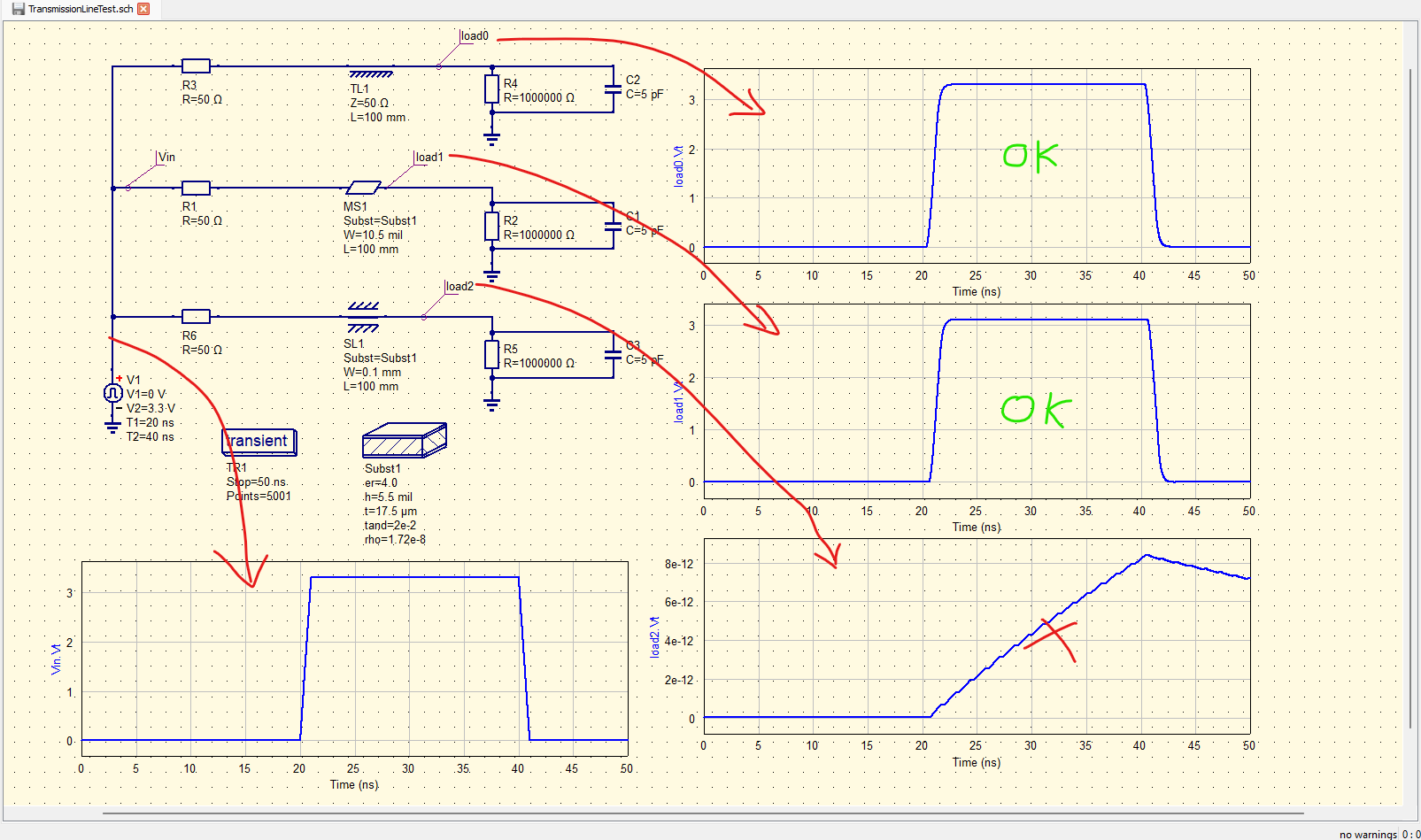

Home › Forums › Usage › Stripline not working in transient simulation Tagged: stripline tranismission line This topic has 3 replies, 2 voices, and was last updated 6 months, 2 weeks ago by Joel_Vic. Viewing 4 posts - 1 through 4 (of 4 total) Author Posts 11. May 2026 at 5:52 #9251 Joel_VicParticipant Hi All, Both the ideal transmission line and the microstrip transmission line are working fine, but not having success with the stripline no matter what I try. Not finding any documentation on this, or google results. Any help would be appreciated. TIA. 12. May 2026 at 4:34 #9252 Joel_VicParticipant The load-side of the microstrip shows a good signal, but the load-side of the stripline does not (lower-right plot). Does stripline not work for transient simulation ?? 12. May 2026 at 13:05 #9253 QucsStudioKeymaster This is indeed a bug. Thanks a lot for reporting it! It will be fixed in the next release. 14. May 2026 at 6:00 #9254 Joel_VicParticipant Thank you for letting me know. I look forward to the next release. 👌 Author Posts Viewing 4 posts - 1 through 4 (of 4 total) You must be logged in to reply to this topic.
