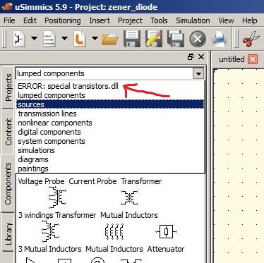

      When I try to select Components–>Special_transistors I see this error:
      Earlier versions (e.g. v4.3.1, v5.8) appear to load correctly. Any idea what may be broken?

        After some exploring, I found this error was triggered in v5.9 by a stray “special transistors.dll” file in the user_lib folder. This dll file has no impact when running earlier versions (e.g. v4.3.1, v5.8 etc.). I think this is a bug since uSimmics looks in user_lib for custom (.lib) libraries.
