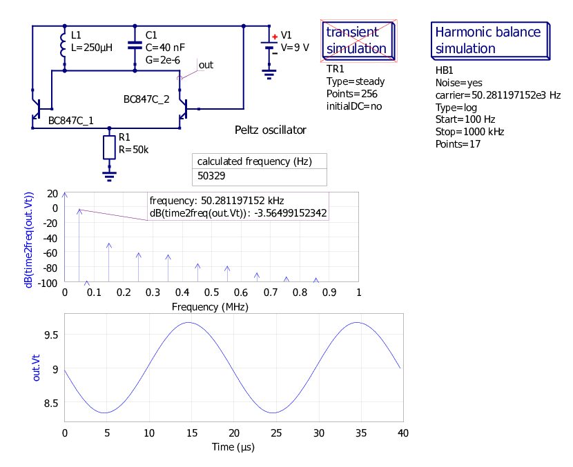

Home › Forums › Bug Reports › Oscillator Phase noise This topic has 0 replies, 1 voice, and was last updated 11 months, 3 weeks ago by sumitd. Viewing 1 post (of 1 total) Author Posts 19. November 2025 at 13:09 #9152 sumitdParticipant Hello, I want to know can we get the phase noise of an oscillator from hb_analysis ? I am trying with the example of Peltz_oscillator.sch which is present is Simulation_Tran package ? Attachments:peltz_oscillator_HB.pdf Author Posts Viewing 1 post (of 1 total) You must be logged in to reply to this topic.
