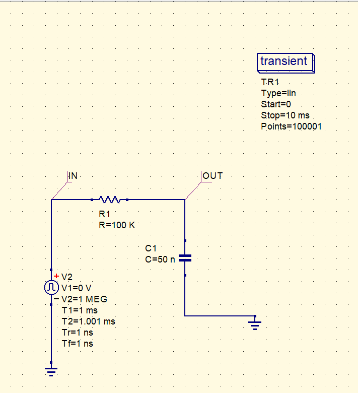

Home › Forums › Usage › Is this a Bug that i have found? Tagged: Bug in new version, Confusion, Tutorial This topic has 1 reply, 2 voices, and was last updated 5 months, 2 weeks ago by Max1499. Viewing 2 posts - 1 through 2 (of 2 total) Author Posts 26. May 2026 at 19:00 #9256 Haziq123Participant Hello, I was trying a tutorial program. In the RC filter shown, R=100K and C=10 nF. so time constant=nearly 1ms. So, when I plot using cartesian plot, this is what I get: Note that, this is the original ckt.—-> So, not proper cartesian diagram for Out.vt 28. May 2026 at 8:56 #9257 Max1499Participant There is no bug. You used an upper case K to abbreviate 100000Ohms. Use lower case k instead, that will work. An upper case K is ignored (written in the documentation), hence “100K” is interpreted as 100 Ohms, which explains your simulation result. Regards Max Author Posts Viewing 2 posts - 1 through 2 (of 2 total) You must be logged in to reply to this topic.
